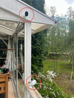

It worked for a while and both cameras were visible (they are next to each with good signal strenght.

The issue is that apparently that one camera is essentially out of range for the WiFi connection to the hub. You could swap cameras around to verify that the issue stays with the location. Relocating the camera for a better connection while still getting the coverage needed would be the solution.

The two cameras are next to each other but one slightly lower.

In any event, that's different from what you initially posted about which was for a camera going offline. Switch the 2 cameras around to see if it's the camera or the location that causes the problem.
