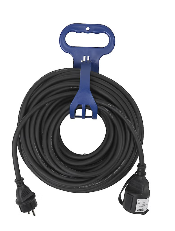

Here is the outdoor cable I am using.
As you can see in the picture below, the AC adapter does not fit properly; it doesn't fully connect.
What extension cable should I use instead to make it work?

First double-check that the extension cord and the outlet is ok. Try connecting something else to it, and make sure that it works.
The charger should plug should insert all the way into the socket. Do you have any similar issues with other devices you plug into the extension?
I have tested other devices, and they work perfectly if it is a round Europlug. However, it does not work with Arlo's flat Europlug because the pins do not reach the bottom. The design of the adapter prevents it from fully inserting (see my image above).
However, it works if I use a dusk-to-dawn sensor between the extension cord and the Arlo adapter. Could this be because the sensor has a cover that protects the Arlo adapter?

Likely it is because the pins on the Arlo connector are long enough to reach the power when plugged into the sensor, but not long enough to reach the power when plugged into the extension.
I was thinking that the sensor connector might be somewhat shallower because there is a cover above it that protects the connector, but for the extension cable, there is no cover, so the connector itself must be deeper, which leads to the problem.
Does anyone have a solution for this? How should one extend the charging cable outdoors? I have tested several cables but the same problem persists with all of them.
