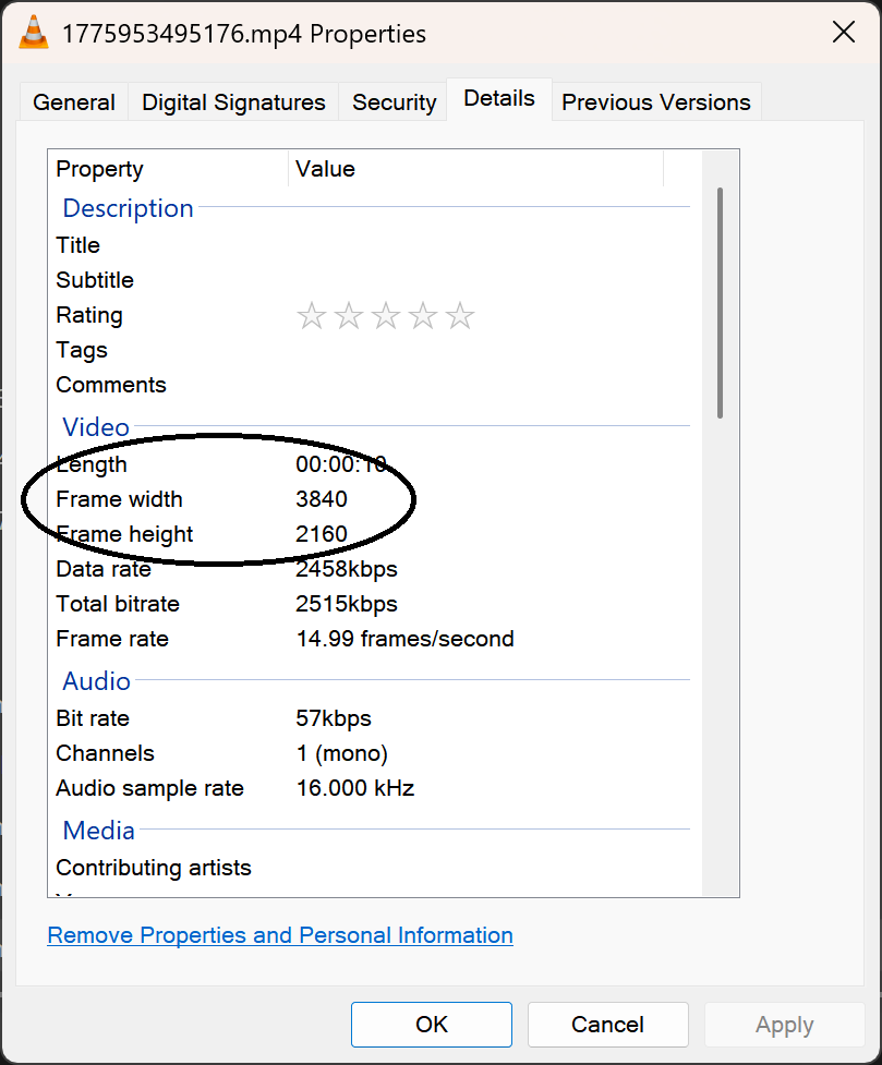

In the USA, which plans support 4k recording and playback. I have 4k cameras, and the Secure Plus Unlimited plan, but the playback in the app is definitely not 4k
The overall quality is limited by the low bitrate, not the resolution. Download one of the files to a PC and take a look at the details there.
Other factors -
- Since the zoom is digital, zooming in the field of view will reduce the resolution
- if you have turn on auto zoom and tracking, the resolution will drop to 1080p
- If you have a CVR subscription, resolution will also drop to 1080p

Here in the UK, according to Ofcom, over 83% of households have access to gigabit capable Internet connections (the lowest upload speed offered by BT is 10mbps; download 50mbps when I have a quick scan over the available offers in my area, which is fibre enabled); copper-based connections (DSL, low upload and download speeds) are just over 6% of all connections. Isn't it the time Arlo improved the quality of recordings if download/upload speeds are indeed one of the factors? I think that kind of low quality of recordings would have been appropriate in the 90s (had Arlo made cameras then) or early 2000s. It's 2026 and technology has moved on big time. So have the users' expectations. The dev team know it themselves: probably using AI to write the code and software engineers fixing whatever AI doesn't get right.
Which is still a barrier.
That said, I'd love to see Arlo provide an option to increase the bitrate in exchange for shorter retention. I've posted that here several times over the years.
