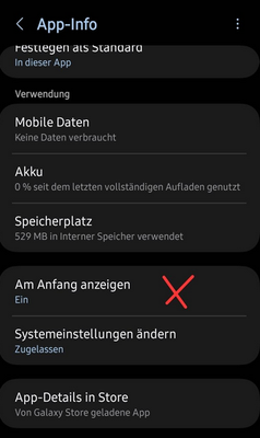

What I noticed, where it still worked, was the option in the app: show at the beginning (that's what it says in German on Android).
This option is missing for me and my wife after the last updates (when the Problems began).
Isn't the missing option causing the problem? End of 2024 we had this option and everything worked so far.
Here is one example picture.

Above screen is from Android setting, NOT ARLO app. Could this "2024 option" be missing, due to any recent update to your android 14?
@Trusti wrote:App version 5.4.3_28791
Android 14
Samsung Galaxy One UI 6.1
Alex
(side question: given you have updated already, where did you get above screenshot?)
This was an example screenshot from the internet.

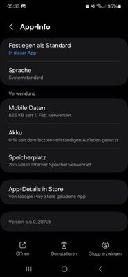

Here are the ones from my Samsung phone (Galaxy S22). My wife has the same thing.
You can clearly see that the option is now missing in both the Android settings and the Arlo app settings. And it was definitely still there until the end of 2024.
If this had happened through an Android update, I wouldn't have countless apps that have this option.
Whether this missing option is really responsible for the errors is another question. But at least an indication of why it might no longer work for me and my wife and others.
