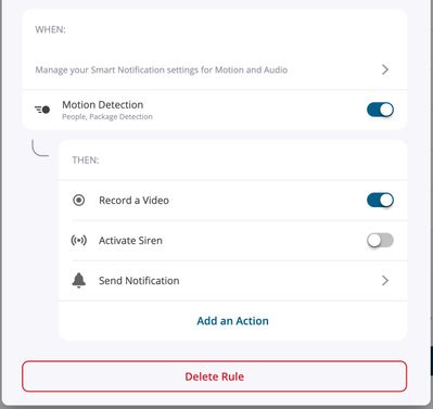

There software even shows that they have changed it. Look at the picture below from the Edit Device Rules. It shows there that for you to even be able to record it has to sense motion (ok, good) and that motion for me is restricted to my two smart notification selections (People and Package). There is even a link there to manage your smart notifications. This needs to be corrected ASAP.
