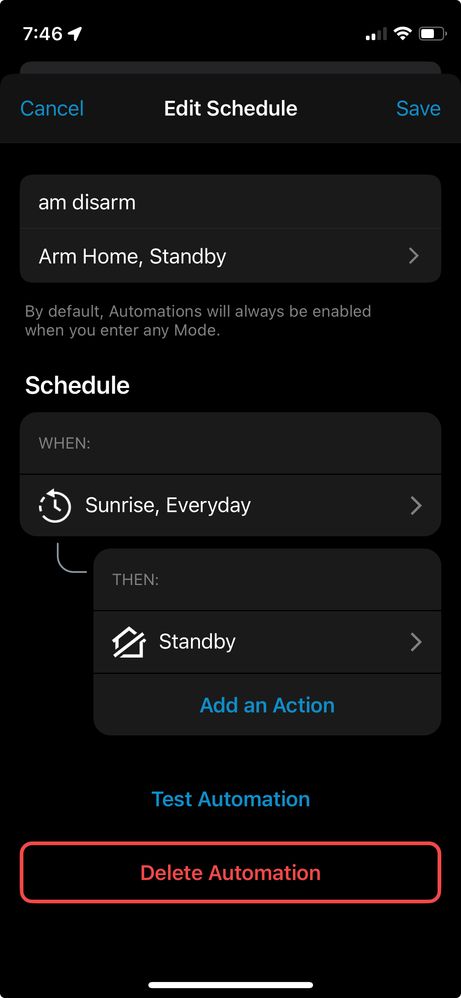

Then set up the two schedule automations:
- One to switch to "Standby" at sunrise
- One to switch to "Arm Home" at sunset
Enable both of these automations in both "Arm Home" and "Standby", but NOT in "Arm Away".
These screenshots might be useful:
This will give you the behavior you want. When you go away from home (vacation, etc) you manually set the mode to "Arm Away" in the dashboard. All 10 cameras will remain armed until you manually set the mode back to either "Arm Home" or "Standby". Then the schedule will resume at the next sunrise or sunset.
