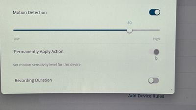

Hey Stephen — first thanks for all the time you’re putting in to help me. It’s very appreciated.
- >>You can just change the enable list at the top - removing "Arm Away". Then the automations won't run when the mode is "Arm Away".<<
Thanks. Was hoping something like this would be possible to use Arm Away without having to actually delete the schedules.
- >>There is another approach that builds on your standby mod - not sure if it will work or not, so it would require some experimentation.<<
Thanks for this alternate suggestion! Sounds intriguing so I’m going to give it a shot and see if works. If it doesn’t for any reason I’ll go with your original plan.
- >>Then the system would stay in Arm Away until you manually change it.<<
This part confused me. Possibly a typo?
Since this scheduling plan never uses Arm Away and instead is set up to improve on my Standby modification approach — (which uses Arm Home 2am—9am) I’m not sure how or when the Arm Away mode is part of any of this. Unless possibly a typo? Or maybe you’re referencing when I leave home this gives me the option to simply manually enter Arm Away — and then manually change back to either Arm Home or Standby when arriving back home. Unless I’m very confused, the way you described modding my Arm Home/Standby schedule w/ using the Front Porch cameras during Standby via Standby rule changes and Customizing sensitivity — the system should be in either Arm Home or Standby.
- >>Then to add geofencing
- Create Leave to switch the mode to Arm Away
- Create Arrive to switch the mode to Standby with a customize device actions to change the motion thresholds of the porch cameras to 80
- When you return home between 2 am and 9 am, you'd need to manually put the system into "Arm Home".
- When you return home between 9 am and 11 am, or between 9 pm and 2 am, the porch cameras would have their motion threshold set to 80, so you would have to manually change that (or just leave them until the schedule kicks in amd resets them). <<
Regarding the Geofencing — is this Geofencing set-up required? Is it required to make your 2nd suggestion about using the Customize Sensitivity actions for Schedules 3 & 4 work?
Or can I simply set-up the Schedules as you described with adding the Customize Sensitivity actions to 3 and 4 without needing to add a geofencing set up?
Im asking because if your 2nd suggestion works then I would simply just enter Arm Away mode when leaving the house for an extended period — and then entering either Standby or Armed Home upon returning depending on the time of day.
My guess is your 2nd suggestion using the sensitivity trick doesn’t require the Geofencing — but you’ve given me instructions on how to use Geofencing to make the use of Arm Away when leaving the house an automated feature. If I got that wrong let me know.
Re: Geofencing I’ve never had to use this feature before. But if I either do need to use it for your 2nd suggestion involving modifying sensitivity - or if it would provide an Automated way to turn on and off Armed Away when leaving and arriving home — I have one extra question.
When I checked out the Leave/Arrive feature I saw a list of older phones — and unfortunately didn’t see my current phone listed. There are two generic “iPhone” entries but have no idea if either of them are supposed to be my current iPhone 13. And I haven’t found a way to alter/change/update that list of phones.
***One last note: When referencing the Sensitivity settings you refer to 0 and 80. Unfortunately, on my app when you Customize sensitivity the slider simply moves between High and Low and does not display a numerical setting. But regardless it should hopefully work as described using Low and High.
I meant 1 and 80 (the app doesn't let you set to 0). My app isn't showing the precise scale either (unlike the default mode setting). All the way to the left ("Low") is 1, all the way to the right ("High") is 100. If you use my.arlo.com for this, you'll see the numeric value over the dot in the slider.

i have implemented the Customize Sensitivity solution you suggested and it seems to be working so far. I’ll give it more time and monitor it through the day and tomorrow to make sure it’s operating as desired — but so far so good! 👍

Update:
Unfortunately, during Schedule 3 with Customization reducing sensitivity to 1 the Front Porch cameras still easily detected motion, recorded and sent notifications.
But I’m curious if this still might be workable. I noticed that in Add Actuon>Customize Device>Sensitivity menu below the Sensitivity slider there is a toggle switch labeled “Permanently Apply Action.” That toggle switch is always set to ON — but is always faded out and cannot be switched off.
Because there is no slider sensitivity setting in the RULES menus that once Motion is turned on — the sensitivity is set to the default 80. I am also assuming that this default setting also comes with a Permanent status despite the fact there is no switch for this.
With the Standy rule for sensitivity being likely set permanently set to 80 once Motion detection is turned on — I’m wondering if there is any way to Add Action to the rule for the Front Porch cameras — where I can add a Customize Action that would set the Sensitivity for a camera — BUT allow me to TURN OFF the “Permanently Apply Action” switch.
I think if that’s possible then when the Schedule Customize Action to kicks in at 9pm to set the sensitivity to 1 — it might allow the camera to truly change/lower the sensitivity to 1.
Overall, I’m stumped why there is this toggle switch labeled “Permanently Apply Action” that is permanently disabled and not usable.
@JamesC Any thoughts about how to turn that “Permantly Apply Action” switch off?
