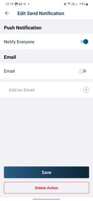

I think I have found the issue with geofencing. In routines/automation and leave I had notifications set to email. I had both the android and iPhone email addresses listed. Today I removed the email addresses and selected notify everyone. Took both phones out of the fence and arlo enabled all the cameras. Came back inside the fence and arlo disabled as it should have. Early days for this change, will report back later. Some pics of what I have done. Each phone got notificatios as each mode was enabled
