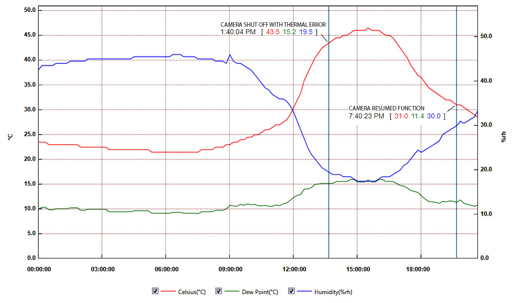

The camera shut down again today for 6 hours.  I put a temperature logger right next to the camera, in case this happened, and the results are below.  The camera shut off when the ambient temperature reached 43.5 degrees C, and restarted when it cooled to 31 degrees C.  Once again, it would be very helpful to know the environmental specs of the camera so that it can be determined if it is operating correctly.
Good info.  In lieu of such info being available, I'd have to suggest a trouble ticket so it can be tracked and addressed properly.

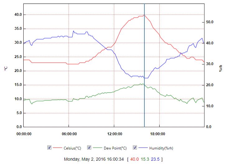

Here is a graph from two days ago (which happened to be another hot day here).  The fan, which is a generic 4 inch USB table fan, is sitting on the sill and is really only positioned to stir the air in the cavity where the camera sits.  Even in this case, it seems to be working to keep the air temp low enough to prevent the thermal error from occurring.  The max ambient temp ends up at 40C.
