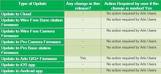

Arlo Q/Q+ firmware version 1.8.4.4_25125.1.2
Fix video freeze on library playback
Fix zoom issue when rotating image
Bug Fixes
