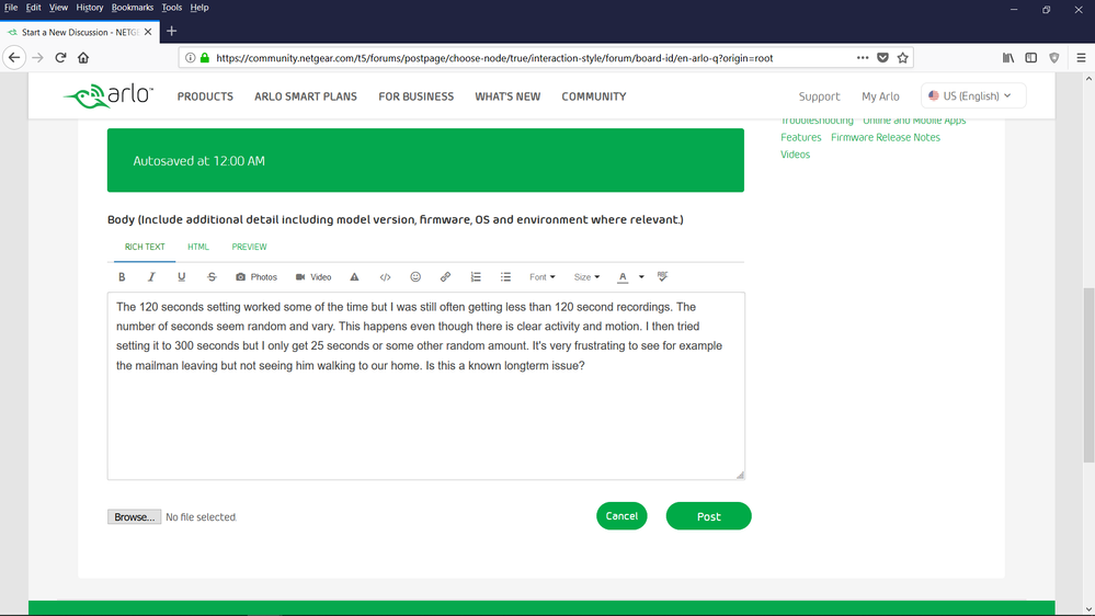

The 120 seconds setting worked some of the time but I was still often getting less than 120 second recordings. The number of seconds seem random and vary. This happens even though there is clear activity and motion. I then tried setting it to 300 seconds but I only get 25 seconds or some other random amount. It's very frustrating to see for example the mailman leaving but not seeing him walking to our home. Is this a known longterm issue?
