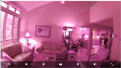

Arlo Q shows pink tainted video
Still occurring after reset of device.
2 REPLIES 2
That's the IR filter that's stuck. You can try removing power and tapping the camera on your hand to see if that helps. Some have even suggested a strong magnet to get the filter to move but I have never tried that.
pink video means the nightvision IR filter is stuck.
Not sure this will work, but I suggest doing a full camera reset.
