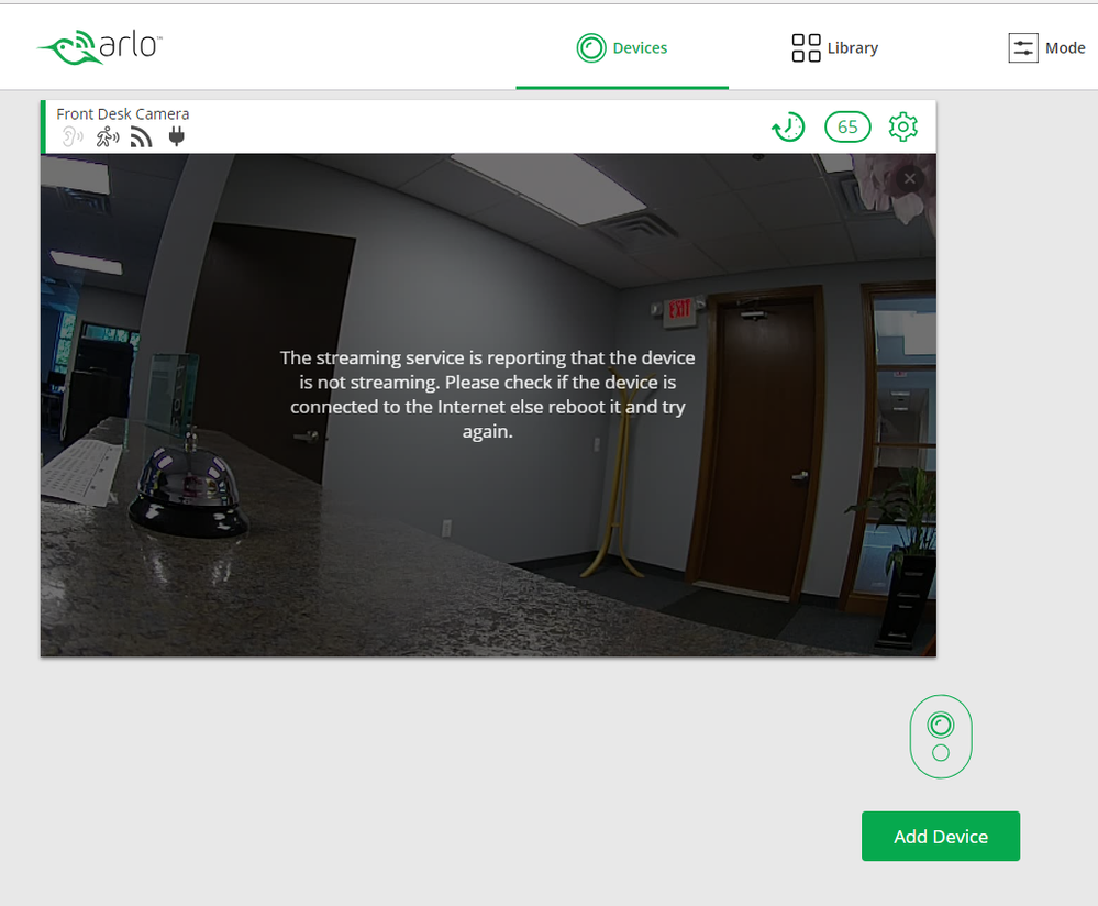

Matt4171
Initiate
Initiate
All of my cameras disconnect intermittantly. Sometimes one will stay connected for a week, sometimes just a few hours. This is very frustrating because they are all connected to the same wifi network, and the 2 cameras closest to my router are the ones that disconnect the most. the only waqy I can get them to reconnect is to unplug the power and then plug it back in. I can't do that if I'm not home. I bought the cameras so I could monitor my home when I'm away.
Community Manager
Community Manager
Matt4171,
When this happens, what is the LED behavior on the camera? What does the signal strength Icon show for these cameras when they are online, it looks like the signal strength is showing poor for the first camera in your screenshot. This could be the reason the cameras are dropping offline.
