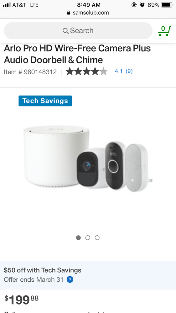

recently purchased an arlo pro system from Sams club. came with 1 arlo pro camera, 1 doorbell and chime. i set everything up and it works well. coming from the oldest arlo system. i was able to pair my other 4 cameras so i was happy to be able to do this. However i cannot turn on the siren. i called tech support and they said the vmb3500 doesnt have a siren. Which cant be right. the lady wasnt knowledgeable at all and wanted to get off the phone. The box says there is a siren right on it. can someone help me with this. ive looked, everywhere. i have no blue icon, and no grey bar on the app. does anyone have that base station and have the siren?

AFAIK, the Pro systems don't come with a VMB3500 base - it should be a VMB4000. The 3500 is small and round, the 4000 is an upright tower. Verify that you have the right system.
https://m.samsclub.com/ip/arlo-pro-hd-wire-free-camera-plus-audio-doorbell-chime/prod22524845?xid=pl...
After doing some research this is what I found out. This is not what we refer to as the Pro system, (VMS4000). It is an updated version of the original Wire Free HD system, (previously the VMB3000). It does not have a built in siren.
Brian
I don't own this model base, but possibly it was referring to the doorbell that can possibly act as a siren. Please send a picture of the box.
Also, does it say anything about activating a siren in the manual?
Brian
Hi @JonS1,
Adding onto brh's comment, the Round Base Station (VMB3500) is a newer design and the functionality between the original Arlo Wire-Free Base Station (VMS3230) is the same. It is different with the Arlo Pro Base Station (VMB4000) so it will not have the siren included.
