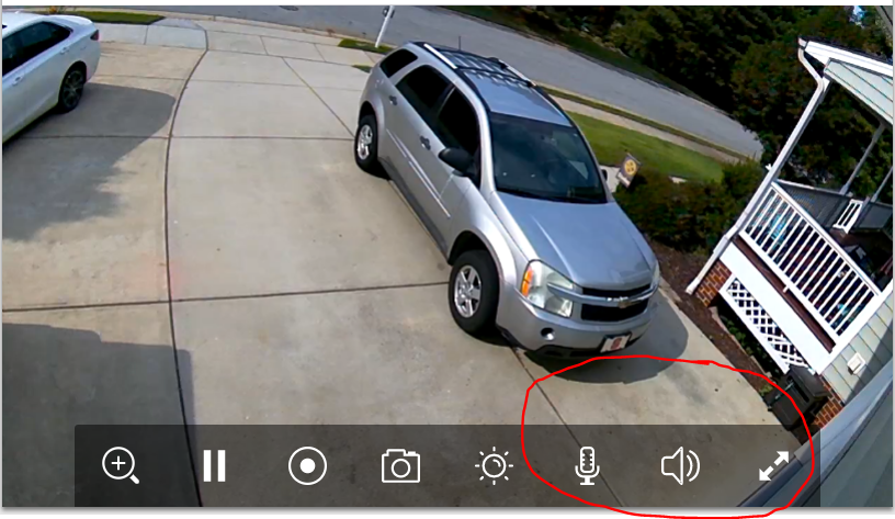

kgrlamm
I have been playing with the placement and sensitivity based on your response to a few posts yesterday, but the view below is a great example of what I'm still battling with. The car pulls up in the driveway, the person gets out and walks into the garage. The recording doesn't start until the car is already parked, the driver is out and walking into the house. I get about 2 seconds of video starting when the person is in the red circled area, and then 6 seconds or so of nothing.

TomMac
In the dog issue, I can understand it's not picking up the dog... first the dog is small than a person, coming straight in AND I would think maybe the camera is to high. ( est the fence is 4ft ?)
As mentioned above,  Not to over cover areas with the camera...the camera has ( for people ) a range of about 24ft max so I usu suggest not to try and cover more than that...the dog is smaller and has less IR to detect.... with pets I've only had good luck bringing the camera more down to their level
You might be able to temp mount on a post near the fence if trying to catch the dog giving presents.
TomMac
With the car... can't really answer why, the pros response is very good most of the time.
I may just try and move the camera around the drive from where it is... temp mounting till it fuctions well with good response.
I know it's a pain I know I moved each of my outside cams at least twice and one three times till I was happy.
Maybe over by the gutter lead drain / corner of porch or above the dryer vent ( but up about 7ft )

I boosted my sensitivity to 100%.  It has significantly reduced the delay in the start of the recording.  When I put it down to 90 or 80 to eliminate the cars going down the street, there's a huge delay in the start time.  I guess you'll need to trade battery life and excessive recordings for faster response in the recording.  Also, you need to consider that the cameras work best when objects move across the field of view, and not directly at it or away from it.   It's also sensing temperature differences as well, so if your air temp is 98 degrees, and a human is 98 degrees, then the camera will detect the person, but it may be delayed.

JerryR
Luminary
Luminary
For the car, can you move the camera around toward the left so that it points to the center of the drive? That way the car entering would be across the field of view.
