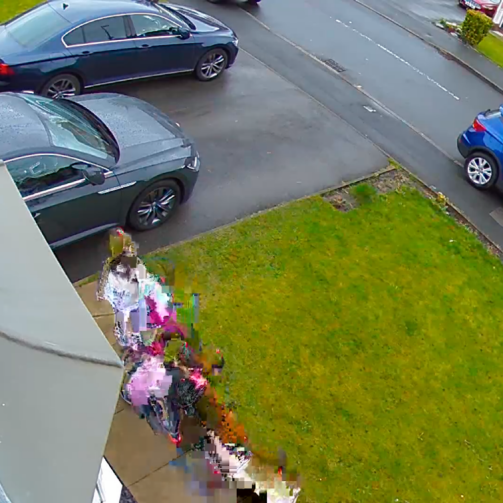

All my videos now have a motion "trail" following the moving image. In other words, say a person walks in front of the camera for a distance of say 5 feet, you will see that person's image for the entire 5 feet, as if the person is leaving a "trailing" image behind him. What would cause this and how do I fix it? I'd attach an image to this post, but I can't figure out how if there's a way to do it.

All my videos now have a motion "trail" following the moving image. In other words, say a person walks in front of the camera for a distance of say 5 feet, you will see that person's image for the entire 5 feet, as if the person is leaving a "trailing" image behind him. What would cause this and how do I fix it? See the image below.
I think there are a couple of possible causes - including a hardware issue with the camera and possibly bitstream corruption along the path between the camera and the cloud storage.
Start by removing/reinserting the battery, and see if the issue resolves. Then I would suggest moving the camera fairly close to the base (indoors), and see if you still have the problem.

@joegumina wrote:
but soon realized was still getting these motion trails.
The motion trails are happening because there is packet loss along the path (camera -> base -> cloud). It's most commonly on the camera->base link.
If the camera is on AC power, then try disconnecting that power - some here have reported that sometimes AC power seems to provoke this problem.
Otherwise, look at the signal strength on the particular camera. As a test, try moving it closer to the base station and see if that helps.
Another test that is sometimes useful is to connect USB storage to the base station (if your base station supports it). Then you can review the recordings on the base, and see if they also have the corruption.
