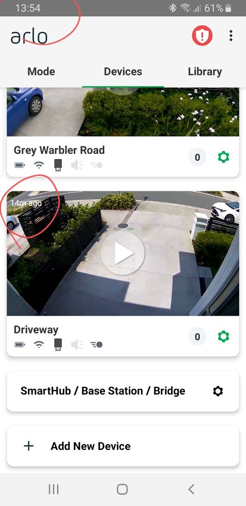

Attached photos of what I am talking about. Note time of day,
in top left hand corner.
And the time of last recording (14 mins ago) on the cameras thumbnail.
Then looking at the clips available on my Library (cloud) None are displayed for 13.41. But it is on the usb attached to the base station.
Which I have to remove from the base station and view on a pc.

Second screen shot. Only allowed to upload one photo on mobile app
