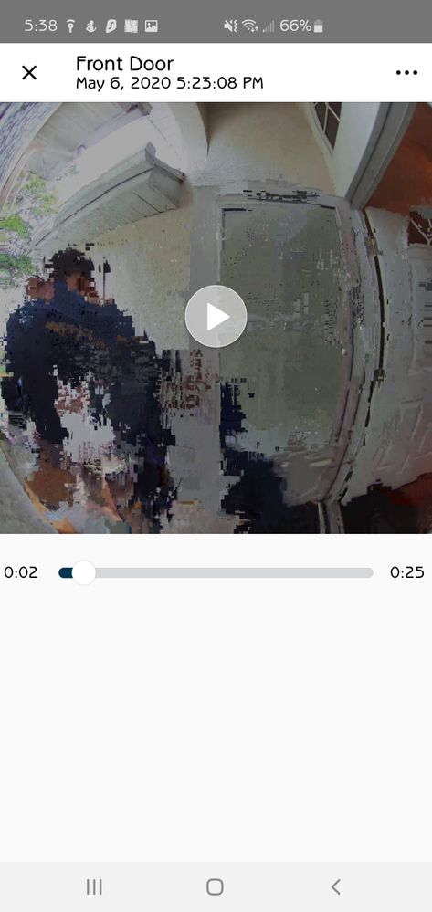

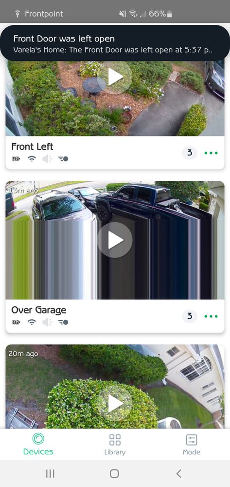

My three Pro and two Pro 2 cameras all exhibit identical behavior - severe pixelation starting a couple of seconds into the recording, lasts until around 10 seconds, then the picture will alternately clear and become fuzzy/pixelated from then on. It seems like every time there is movement in the field of view the pixelation begins. I really noticed this when I had taken the cameras down to remove/reboot/re-sync them. After reattaching the cameras, when I was holding them in my hand, every time I moved them a little bit the picture would just break up terribly. I'm still seeing the poor picture quality this morning. Again, first happened in late April right after the firmware update on the cameras and base station.

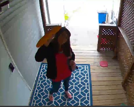

I have attached a recent camera grab from this week. My wife almost 3 feet away from the camera and can barely tell who it is. I have other captures from late last year and they look fine...
