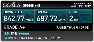

My internet speeds are just fine. I'm on a 1Gbps fiber connection. Latest speedtest (not isolated): http://www.speedtest.net/my-result/6038938781

Not to belabor the point but here's a speed test I just did. My 1Gbps fiber pipe ain't the problem.
