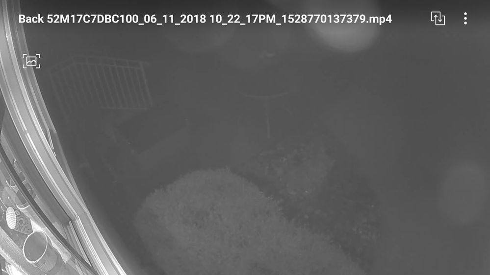

I think I'm having the same problem. My camera was fine up until about a week ago but now suddenly the night vision is very foggy and hazy. My other pro 2 has no issue. Not sure why this has happening?
Jinnyjam,
Can you provide a snapshot so we can see what you're describing?
Here is a snapshot of what it looks like. I think I figured out the problem though. Looks like there was some bird poo or tree goo or insect eggs on the camera, blocking the infrared lights. 🙄
