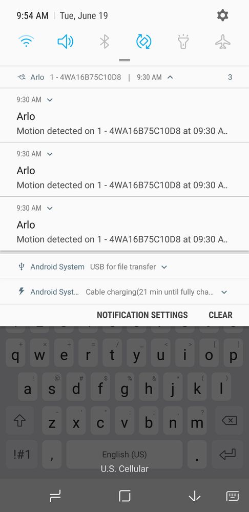

I have five Arlos and two Arlo Pros on two separate base stations. I was getting double notifications for each event on my Galaxy S8, so I uninstalled and reinstalled the app...now I'm getting three notifications for each event.
JoeCymru
Virtuoso
Virtuoso
Uninstall and reinstall again and you can have four. The number seems limitless and is only bound by one's own desire to continue the uninstall / reinstall process. I gleefully got my S8+ up to thirteen to prove a point to myself.
