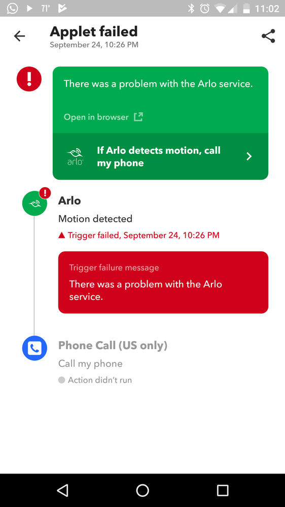

This recipe was working fine earlier and stopped working since last few days.
JamesC: I realize things take time...2 months with no communication whatsoever by either party is a bit long, don't you think? FYI, the IFTTT Applet says 'There's a problem with the ARLO SERVICE', not the IFTTT service! Look like each party blames the other and neither is concerned about any of this in any way. Too Fat & Happy.

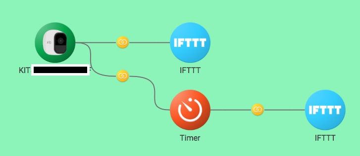

Anyway... like others have stated on this string, you can work around this Netgear/IFTTT problem by using Stringify (hopefully, Netgear doesn't break this linkage as well). I use Stringify to capture the motion detection from the Arlo camera, and then pass this trigger to IFTTT to turn my Lutron/Caseta light switch on/of (Lutron doesn't support Stringify, which is why I have to use both services). See attached.

An update went out late last week that should resolve the issue users were experiencing with IFTTT applets failing. Please let us know if you are still experiencing an issue.
I just tested the IFTTT rule - if motion detected turn on light, and it worked. I am pleased it is working again.
I am not home to do a physical check. What is supposed to happen when pressing 'Check Now' from the IFTTT app?
