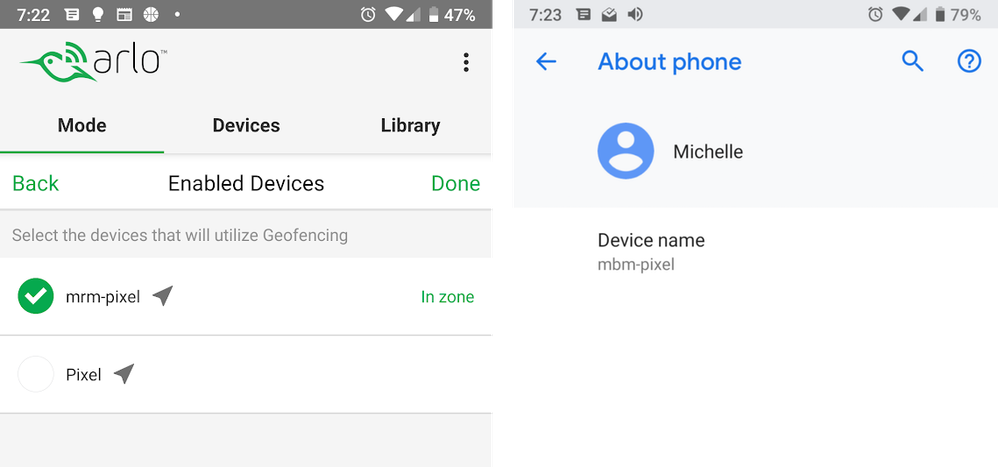

I understand that we cannot delete unused enabled devices from the Geofencing settings (fingers still crossed this comes soon), but my issue is a bit different. Both my wife and I have Google Pixels (Android 9).
I set up both mine and my wife's phones to use our new Arlo Pro 2 cameras. I realized that my wifes device name was set to the default 'Pixel' so changed on her phone to 'mbm-pixel'. Now her phone will not show under my enabled devices list from my account (i'm primary) and her updated device name is not displaying in my enabled devices list. I was hoping at minimum that either her entry that says 'Pixel' would be renamed/updated to the 'mbm-pixel' or add a 3rd entry of 'mbm-pixel'. (Uploaded image for reference)
I've cleared cache, cleared data, uninstalled/reinstalled app, I've removed my wife's account from granted access and added her back. Nothing has helped. Now her phone will not work with geofencing at all.

...and yes, I tried renaming her phone's device name back to 'Pixel'. That didn't work either.
