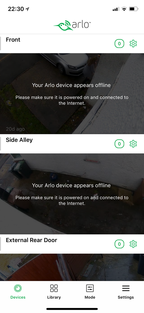

I have the Arlo Pro with 10 cameras and for some reason my hub decided to go off line a few weeks ago.
I have tried logging out then in plus turning the power off and on several times but nothing works and I’m still paying monthly.

I have all three green LED's on the Hub and the error message accross all 10 cameras is "Your Arlo Device Appears to be offline, make sure its powered on and connected to the internet" which all of them are.

Yes I tried logging out and in several times / different browsers / work PC and now using a new phone in the last week or so that has also been restarted.
The devices stopped recording when they went offline.
Just deleted the app and re-installed and still the same messages.
