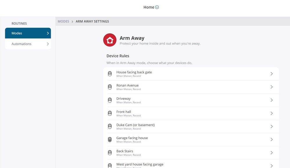

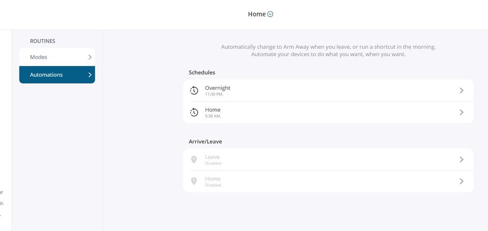

Here is what I have: I just want overnight and daytime - no geo fencing needed. On at 11:30PM to ARM everything and off at 5:30AM to go into STANDBY
Screen shots:
1. The Modes I see to begin
2. Arm Away - I have all cameras set to record motion (only)
3. Arm Away camera example - "House facing back gate" Set to record a Video only - no other actions
4. I have only 2 schedules ... Overnight system on @11:30PM and Home system standby (off) at 5:30AM
5. Overnight I want to record a video set to all cameras
6. Daytime - set for 5:30AM then...

So you did not follow my advice.
Once again, you have only three modes to work with. If you want geofencing, the "Arm Away" has to be dedicated to when you are actually away. So that means you can only switch between "Arm Home" and "Standby" in your schedule.
In your "Overnight" automation, you telling the system to record videos at 11:30 in your schedule automation. That only makes one recording for each camera at that time. It DOES NOT arm the cameras. You are also telling the system to only make those recording when the system is in "Arm Away" mode. What you need to do instead is switch to either "Arm Home" or "Standby" when the system is NOT in "Arm Away" mode.
Your "Home" mode correctly just changes to "Standby". But you are telling to always switch to "Standby" at 5:30 am, even when you are away.
I suggest deleting all of this, and trying again to follow my advice.

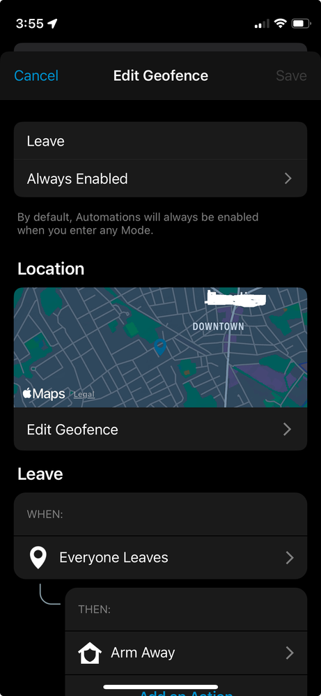

It is also possible to add geofencing, to automatically change the mode to Arm Away when you leave, and to change it back to Standby (or perhaps Arm Home) when you return. Several users have reported problems with the geofencing not triggering when they leave or arrive, so you can't fully depend on the automatic geofencing.
Another factor is that when you return, the automation will switch into a specific mode (and not immediately follow your schedule). For instance, if the arrive automation switches to Standby, then you will need to manually switch to Arm Home if you arrive after 9 pm. If you forget, the cameras would remain disarmed until 9 pm the following evening.
If you want to set up geofencing, you can use these screenshots as a guide:
Again, be careful with the enable lists. "Arrive" needs to be set so it only runs when the system is in "Arm Away" mode. "Leave" can be enabled in all modes.
