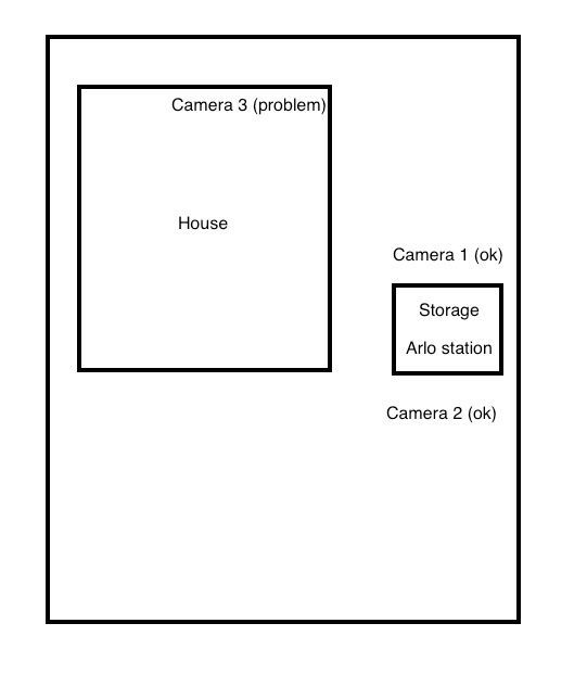

Dont you see the image i posted still? i can see it myself on the forum.
I understand about the extender i think. I can connect the basestation to a wifi extender and i connect the other wifi extender to my router. This can increase the range for the basestation to my router however that is not the problem i'm talking about. The problem is the range for which the Arlo Pro can reach the basestation. Even if i would move the Arlo station in the middle of the house it wont reach outside properly.

Here is the picture again
You seem to be getting a much better signal. Still that wont help me sadly. I dont think the basestation is broken or anything but it can be that it is not that great at penetrating the walls. Still if my router can do it using 2.4GHz band so should this baseband.
