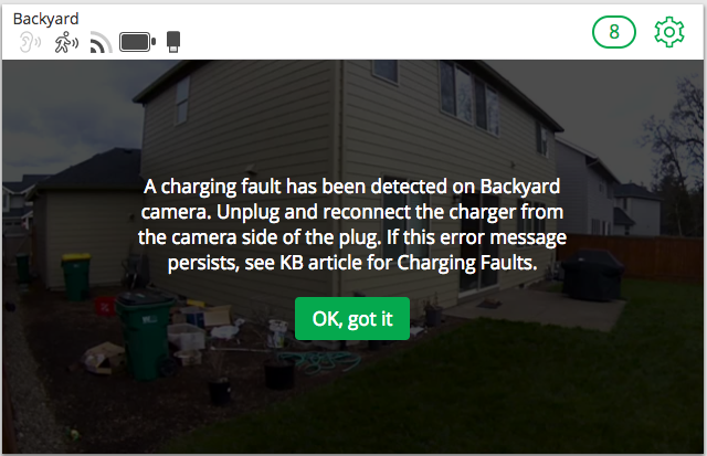

I've had an Arlo Solar Panel hooked up to my Arlo Pro camera for at least two months and everything was working fine. It would charge up when the sun was out and surprisingly even when it was cloudy. A few weeks ago we had some snow and the Camera showed a message saying that it couldn't charge because it was too cold. Made sense to me. After the snow cleared and back to the mid 40s temperature wise, it seems like the Solar Panel just stopped working. Camera's battery doesn't charge when it normally would and when I take a look at the camera through the web, I get the following message - "A charging fault has been detected on <camera>. Unplug and reconnect the charger from the camera side of the plug. If this error message persists, see KB article for Charging Faults."
So I disconnected the camera from the Panel and tried troubleshooting it. Unplugged and replugged into the Solar Panel and still get the same message. Tried plugging the camera to the Arlo wall charger... camera charges up just fine.
Now I'm ripping my hair out trying to figure out what's going on and how to fix this. Anyone have thoughts on what I can do to try and fix it? Haven't had much luck with Arlo chat support. They keep directing me to pages about charging that I've gone over at least 15 times.

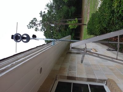

My unit is mounted on an antenna mast and the charging signal is susceptible to stray rf, induced voltage surges, and galactic cosmic rays which are on the increase.
I added two ferrite torroids to the charging cable to reduce charging spikes. Voltage spikes on the charging cable will cause sensitive electronics to "lock-up". The torroids should be as close to the arlo as possible and have as many turns as possible.
