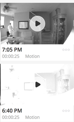

I experiend washed out colors on one of my cameras a little earlier (H8). I removed the camera from the base station, took out the battery, re-synced it with the base station, and everything is back to normal. Prior to getting the washed out colors I had the camera in the same location, but moved it outside by the pool for a few hours, then brought it back indoors, I think that change "could have" made a difference in one of the sensors not reacting. The color is working, and night vision is back to normal.
I then had another camera that completly lost contact with the mother ship and wouldn't re-sync with her. I did the same thing (three times), and it's now back in sync with the mother ship. That camera too is a H8.
See image below of the washed out colors. It's now back to normal.
