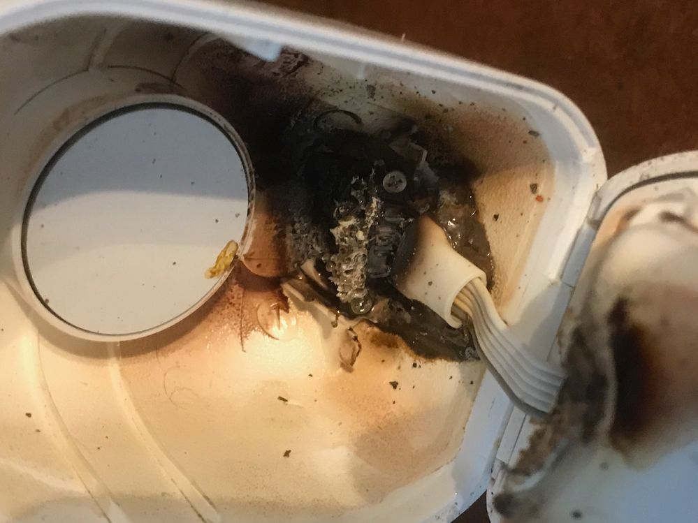

I also have a short due to the VMA4700 which was attached to a pro camera which occurred sometime in the last week while out of town.  Upon opening the camera, the internal usb circuitry is fried, the case to the battery is melted and the tab to remove the battery is melted/missing, rendering the camera useless to even use on battery alone (when the battery finally dies).IMG_8691.JPGIMG_8692.JPGIMG_8693.JPGIMG_8694.JPG
Opening the case may wellbe an issue but open a case with support.
