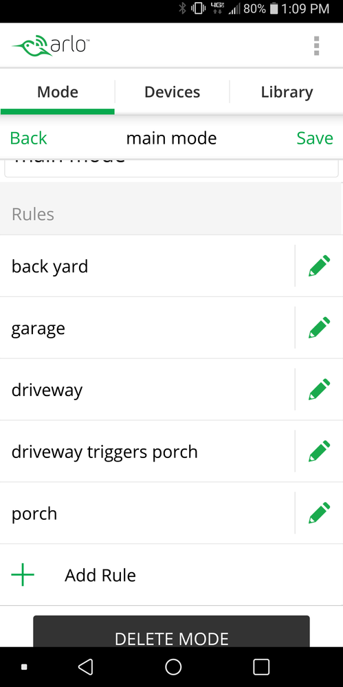

My 4 camera arlo system has been working good for 4 months until recently. I have a custom mode created and several rules under that mode. I keep getting audio alerts now even though I have that setting turned off. When I go in to edit the mode, it has a bunch of changed setting. I change them back to how I want them and about 20 minutes later it will change on it's own again. I've included a picture of what it should be and what it keeps changing to.

This is what the rules should be

Sometimes for unknown reasons the modes get glitched...
Start with the smiple fixes first... like rebooting the base, then correct the modes ( delete and rebuild )
See if that fixes things.
If not then you may have to get more agressive...
Remove the modes along with removeing the camera(s) and bringing them back as new...whne you bring cams back as new , they rebuild the default modes
