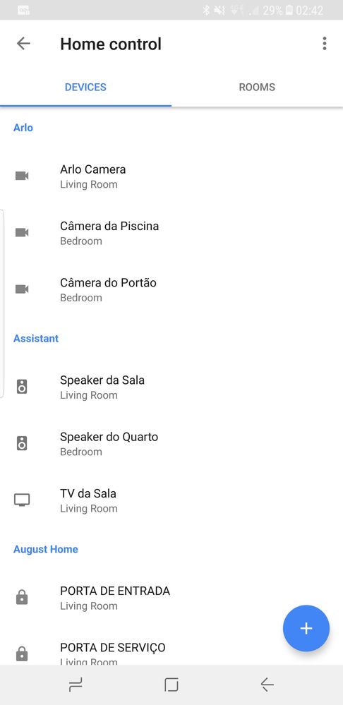

I have the same problem. I bought the station and 3 Arlo Pro cameras. I configured it correctly. Cameras are set up on Google Home. No voice commands are accepted by Google Home. I can not arm / disarm the alarm and I can not see the camera on the chromecast.
If I can not, I will return the product and buy Nest.
