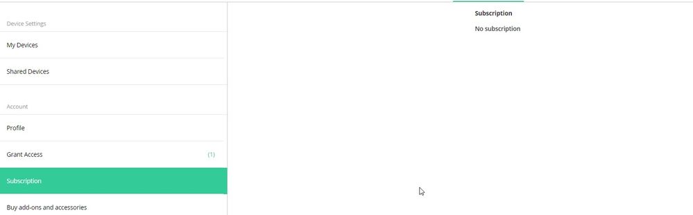

In addition when I go to "Suscriptions" it shows nothing and not really and option to purchase, upgrade or set it up in any way.
