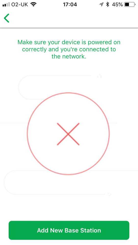

The base station lost one of my Arlo Pro cameras yesterday. Camera had been fully charged previously.
After trying everything I could think of I deleted it from the base station, and then tried to add it once again.
It won't add the camera and appears to want me to add a new base station.
Any thoughts as to how I can resolve this?
My other 3 cameras are working fine.
Have you tried power cycling the base as well as using a browseer? I'm finding a browser to be much better at the moment.
That has done it, thanks! The iPhone app has always been fine until now, so I rarely use the browser.
I'll change my practice in future and use the MacBook.
Thanks again!
