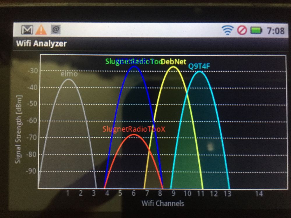

I am not sure why the Arlo base station WiFi channel discussion has been closed/solved because it is still a problem. I am using a professional Pepwave SOHO router and a Pepwave AP One Mini and both routers have hung up due to interference in the 2.4GHz frequency range. I have move my router's 2.4GHz frequency to several different channels like 2, 4, 6-10 and in all cases the Arlo base station NTGR_VMB router has followed the router's channel, almost acting as jammer. When the NTGR_VMB in on the same channel I lose 10-15db's in SNR. This is a problem. The solution of moving the base station > 20ft from the router is unrealistic. Many of us have wives and they would not appreciate the base station sitting on the coffee table or hanging from the ceiling or sitting who knows where. The appropriate solution is to enable the assignment of the base station to a different channel than the router.
Until this happensk this topic should remain open. I currently am working with my Pepwave engineers to come up with a solution to the Arlo induced problem. It is a problem Arlo needs to resolve. They created the issue.

Are you trying to say you have two base stations within 6 feet of the router and the base stations are using the same channel as the router or the base stations are using different channels than the router? Here is why it is important. In my house I have 2.4G and 5G networks. The base station broadcasts a signal on the 2.4G frequency that is the equivalent or slightly greater than my router 2.4G frequency. This has caused the interference on that channel to increase and the throughput to decrease on my 2.4G frequency channel. This has caused my Roku Express to drop off, occassionally my SimplySafe camera to drop off, my Win 10 PC and Canon printer to drop off the 2.4G WiFi network.
I have moved my router's channel all up and downt he frequency and in all cases the 2.4G network would lose its clients periodically over time. It would generally recover but the recovery would be in minutes to hours not seconds. Seconds I could live with.
If you are telling me the base station can be move 6 feet away from the router and it will retain its own channel and not migrate to the router's channel when I change it then I could possibly make that work; but 12 feet or 20 feet. No way. I have not place to go with the equipment.
