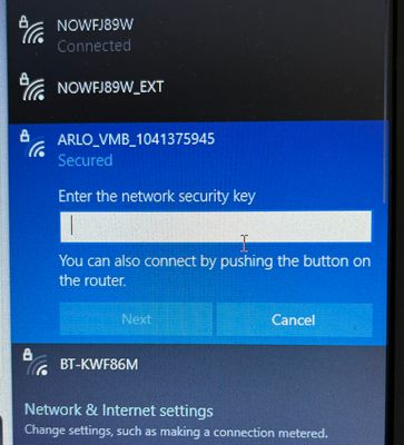

The router’s attached device list shows -
Entering my WiFi password goes nowhere and resetting the router (as suggested) doesn’t enable a connection.
And just to confirm, the internet LED light is unlit.
StephenB
This is NOT your router's attached device list.  This is the list of wifi networks that your device sees - completely different.
You need to log into your router's web ui to see the attached device list.  What model router do you have?
