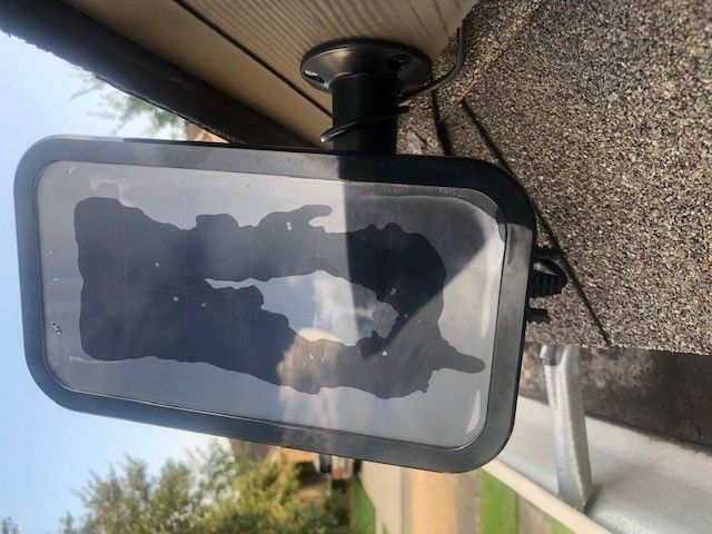

i have purchased a solar panel for my Arlo pro 2, it was working well, suddendly i get a notification that i have to charge the camera, when i went to go look at it, it looks like water got into it and solar panel stopped working, for 80 dollars and to last 3 months is pointless, do not recommend the solar panel charging port. see attached pictures.
