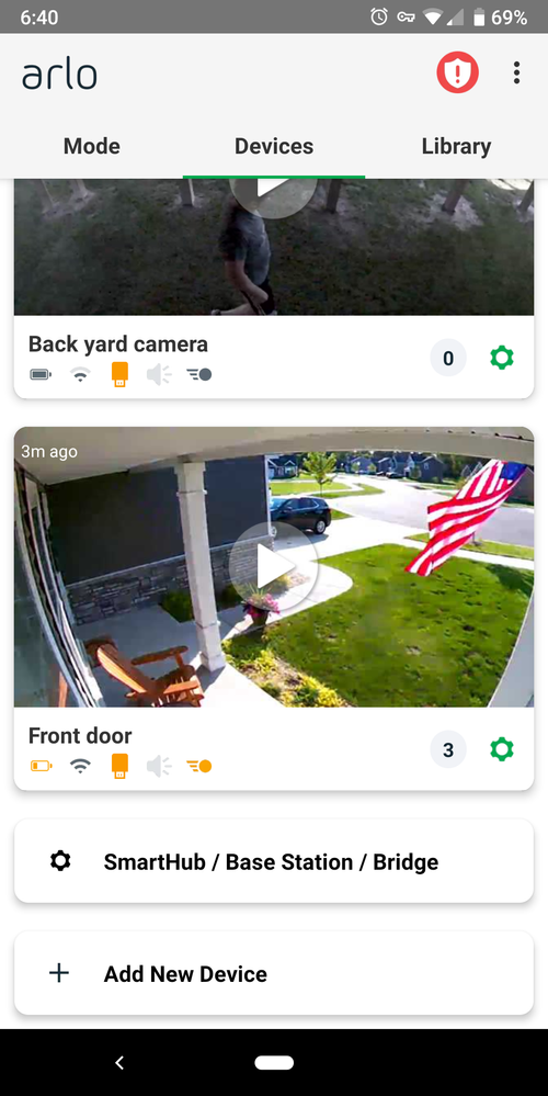

Started noticing last night that after the cameras are tripped with a motion detection, they will record their assigned length video (90 secs), finish the recording, save it to the library, but the yellow motion detection man stays on. After that, it will not pick up any additional motion.
Only way I can get it to reset, is by going in a looking at each camera live view. After that it will turn off. Once I get the next motion, we have to start the process over. Who knows what I have actually missed.

One of my cameras would be triggered by motion, record, but then 'hang' with the motion detect icon lit up in the app (both Android mobile and my laptop). It only occured on one camera and to clear it I had to turn on 'live' view.
I reset the Arlo base using the PC web app. When the base station came back online the motion detect was clear and working properly.
