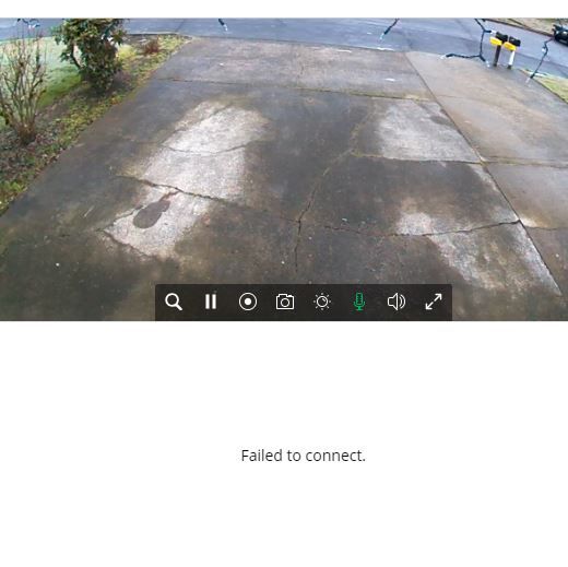

Here is the image of my screen after going into Live View abnd pressing the microphone icon using Firefox.

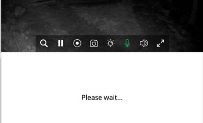

And here is the successful connection to the microphone...now awaiting my click and hold on the larger icon.
jlowenby
Thanks.
I wasn't very good at explaining....I actually meant talk Through the camera, not to the camera.
I am able to do so through the app on my phone and iPad, just not using the pc.  Seems I am having some microphone issues there.  I can live with that...I only really need to go through  the app anyway, like when I'm not home and I see someone at my front door.  Thanks for your help.
jlowenby
The microphone symbol on my phone and iPad are green and when I click on them, I get the little button to press and talk.
It is only on my pc where I have an issue...green microphone button is there but when I press it, it goes red and that is when I get the message saying I need to update my browser.
