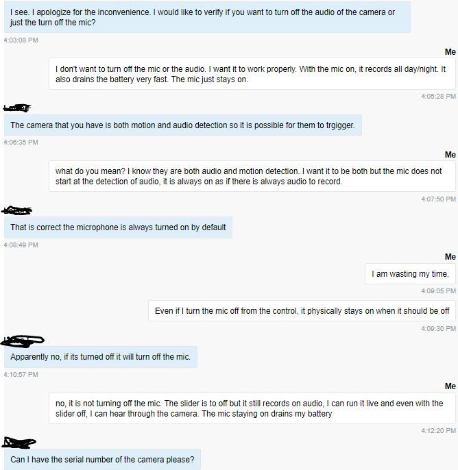

This is my second go around with this issue. I tried an online chat with support and exchanged messages with someone I am fairly certain has never operated an Arlo sytem or possibly has never even seen the controlers. That is 20 minutes of my life I will never get back.
The microphone on two of my cameras will not shut off. It constantly records and drains my batteries. I will turn the microphone slider to off and the mic still stays on. I can run live view and still hear through the camera even with the mic off. I have reseated the battery, changed batteries, removed it from the system and then reinstalled. Still open mic. I can set the mode that when audio is detected, to do nothign and it still records.
Support told me that both audio and motion are triggers so it will record. Huh, you don't say. Me: the mic stays on even if I shut it off. Support: That is correct, the microphone is always turned on by default. Uggg. I was then told that if the slider is turned off, it will turn off the mic. No it doesn't, that is my problem.

Update: The same service chat person posted that he could go into my setting and shut off the mic for me......#facepalm
