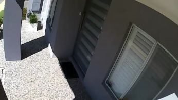

You can see screen shots attached for the front camera there is noting else that could give the false trigger , and it only happens on the front camera during sunrise which cast long shadows and sunlight over the front of the house .

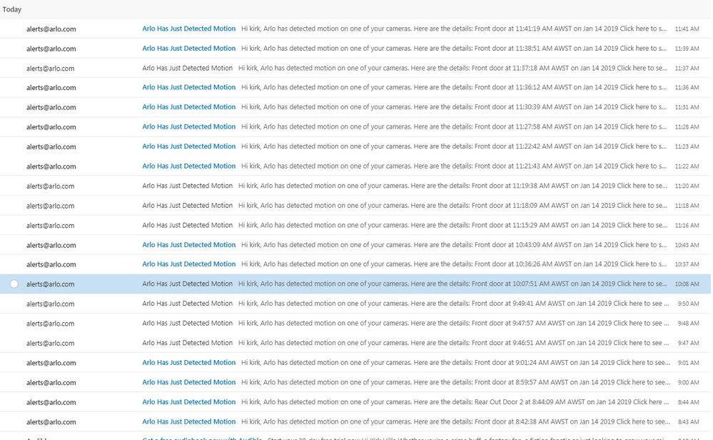

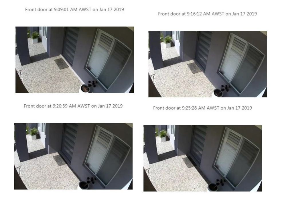

Well seem Arlo / Net Gear cant be bothered to reply or look into the current issue with Sun light / shade combination setting off the cameras due to an update they did to the algorithm . attached is a picture of the notification from the front door camera over 30 false triggers so far this morning with the camera sensitivity set to less then 5% , this is become a joke , I was lucky to get 3 false triggers previously when it was set to 80% sensitivity and there has been no changes to the outdoor environment as above post and it is not a hardware or camera issue as they are all having the same issue . Even one of my work colleagues who has the Arlo system with 10 cameras all different models and purchased at different times and shops has said the same with in the last 6- 12 months since they did an upgrade he has got nothing but issues with false triggers with sunlight

So even tried to adjust the camera sensitivity down to like 2 or 1% today and set a zone for the front camera just around the upper part of the front door yet still getting like 40 odd false triggers as day . As per screen shots attached there isn’t much that has moved just the angle of the shadow with the rising sun . Funny how this never happened in the 2 years prior to the update with the sensitivity set to like 80%
There's a lot of potential for reflected IR from the sun in those shots but unless something is flying through the scene, causing a flicker, it doesn't seem likely to be the case. You are changing sensitivity in your modes, right, and not in the motion test? If so, open a case with support:
