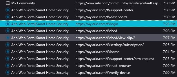

The behavior came back.
I was scrolling through my Feed page. Click on a video, watch a bit, go back to the feed.
Right in the middle of scrolling on the feed page I got logged out. I just checked my browser history and I logged in with 2-step verification at 7:20PM and was forcibly logged out at 7:28PM.
Firefox 137.0.2 (64-bit).
