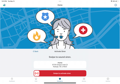

I go to devices
Select a camera with a siren
Start live streaming
Expand the live streaming view to full screen
Tap the emergency icon in the top right corner
This brings up the emergency response screen.
Only option is activate siren. Does not allow selection of which device.
Slide the bar to activate and only the base console sounds.
Same issue on both iPad and iPhone running latest version of iOS
Base unit VM 4500r2 firmware 1.26.0.0_4612_12a0681
Arlo app version 6.0.4 (9414)

Can you send me a picture of your routines for the camera with the siren and then a picture of the spot you marked activate siren, when you click next it says choose a device that you would like to use for this action can you send me a picture of that as well.
Not sure if the pics uploaded.
Pic of screen with camera view and icon i selected to activate siren
Pic of emergency response screen
Pressed activate siren
Pic of screen to swipe to activate. Does not show any option select a camera.
Let me know if the screen shots uploaded ok.
Even if I just try to activate sirens, and even though it shows my 3 cameras and the base unit all checked, only the base unit is activated.
