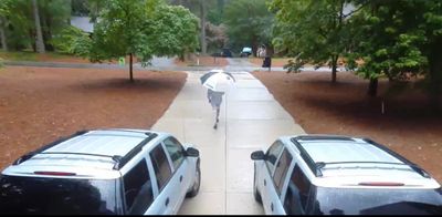

@BrookeN and all.....Just some FYI:
Didn’t see a way to upload a video so I took a few snapshots from my Driveway cam5s video.
It Detected & recorded me all the way up the driveway to the street perfectly…shut off when I turned to the mailbox.
I came right back down the driveway the exact same way and it never detected / recorded a thing.

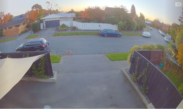

I am actually really impressed that your camera does pick up movement so far away! I wouldn't have expected it to work over that distance at all.
This is the view my old Pro 5 had and wasn't capturing anything on the street, just pedestrians on the near side pavement:
After reading the documentation I realised the it is most sensitive in the bottom two thirds of the view so moved it up 10 degrees or so to this view instead and now it captures dozens of car movements a day:
