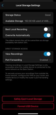

Kenny7522
@StephenB
hi StephenB,
I don’t any video record in my ARLO app. But the setting should be all good?
Photos for your reference.
Thank you.
StephenB
This is set up correctly.

Kenny7522
@StephenB
1. Armed mode.
and record when it detects motion.
is it correct?
2. Yes, I have notification when it detects motion. But nothing video recorded.
StephenB
@Kenny7522 wrote:
1. Armed mode.
is it correct?
This looks fine.
Are you looking in the storage settings, not the feed?
Also, have you tried ejecting the microSD card using the app, and then connecting it to a PC?  That would help determine if this is a recording issue or a playback issue.

Kenny7522
@StephenB
Not feed.
nothing in storage settings.
It would be recording issue.
always 192kb used of 512GB USB disk.
Never use any memory.
thank you.
StephenB
I suggest ejecting the flash drive in the app and connecting it a PC.  If the PC offers to "repair" it, then let it do so.
You could also remove the base and camera from the account, reset both devices and add them back.
You reset the base with a paper clip.  To reset the camera, you remove it from the housing and press the sync button inside until the camera LED flashes amber (~ 15 seconds).
