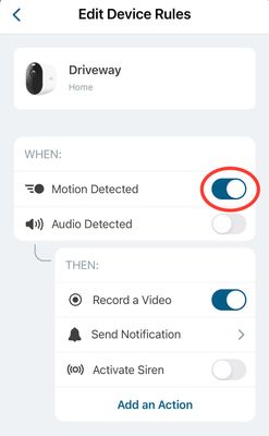

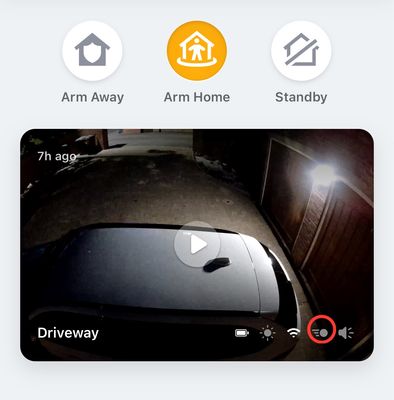

@BrookeN Hi there, same thing has happened again. The camera was working as it should, the first screenshot was from last night, I powered off my phone and this morning when I checked, the motion detection was off again??
See 2nd screenshot. Switching to standby and then back to Arm brings it straight back on.

@BrookeN  Hi there, in answer to your previous question, the motion detection icon was off again when I woke this morning, but the motion detection toggle was still on. See screenshots

@BrookeN Update, This morning I left the app as it was, motion detection toggled on but the motion icon greyed out and it’s picked up every single event.
A couple of days ago when I tested in the dark with the motion icon grey out, the spotlight came on but there was no event recording or notification??
Maybe something to do with when it’s dark perhaps??
