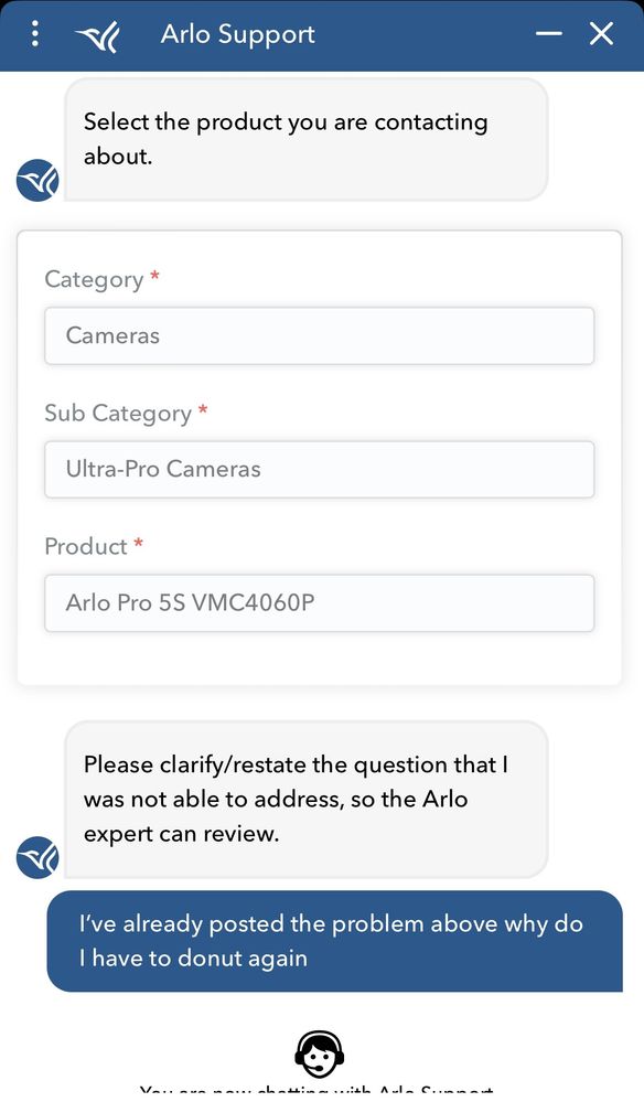

See attached screenshots of support conversation. Apparently if the support person decides he doesn't want to help anymore he just lets you sit there and ignore you. See conversation from start to finish in the 5 screen shots attached. Arlo buyers, beware. When things go wrong support is MIA.
