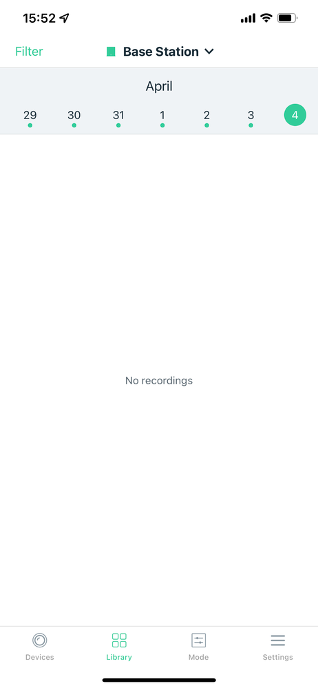

My initial trial period has expired and I understand that a lot of features went away...but I've been successfully recording locally throughout this period. I have Arlo set up on a laptop, tablet and my phone. When I go to the library I encounter a blank screen with the message "no recordings." After trying this on all three devices, going back and forth, finally on the tablet there appeared a filter at the top to chose between the cloud and the smart hub. But that filter doesn't appear on the other devices! Why doesn't the filter appear on the other devices and how do I enable it? Thanks.

I have a similar issue , I’ve started using the local recording using a 256GB USB memory stick a week ago, everything worked great for 7 days and starting today I get “no recording” in the library.
Have you double-checked
- that you can live stream the camera?
- that the camera is armed?
Also, it might be worth removing/reinserting the battery in the camera, and maybe also restarting the base.
