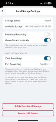

wrparker
I have the 4540
this is the screen shot of the settings:
StephenB
Unfortunately I don't have a VMB5000 base on my test account with "Feed" - the base is in an account with "Library".
I am wondering if you ended up on the correct settings page. Did you use the steps that I copied from the KB article above?  They are at the end of the article:
wrparker
I think I have it now. I can see my local recordings. But I have to be connected to our home Wi-Fi in order to do so.
Apparently I need to buy a subscription to see my local recordings when I’m NOT connected to my Wi-Fi or suggestion was to setup a VPN connection on my router and mobile. I might look into that because I only wanted to buy a subscription when we’re away from home for an extended period of time.
thx for the help.
StephenB
Not quite.  With a subscription you get cloud recordings, so no need to see the local ones when you are away.
@wrparker wrote:
or setup a VPN connection on my router and mobile.
Port forwarding is the other possibility.  You'd reserve the local IP address for the base in the router, and then set up port forwarding in the app.  That will give you the port numbers you need to forward to the base in the router.
Either way, port forwarding and/or a VPN won't work with some internet providers.  Mobile Broadband for example doesn't allow any inbound connections.  Some landline providers use a technology called CGNAT, which also doesn't support inbound connections.  But I think some of them can disable that technology for your account if you run into that.
