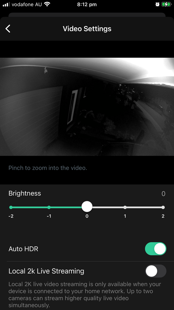

Pro 3 night vision
Why is this happening is it a faulty camera
1 REPLY 1
The IR LED used for night vision is reflecting off the nearby wall, causing the camera's autoexposure to darken the image (it sees a brightness and tries to adjust for it). Position the camera to remove the wall from view as much as possible.
