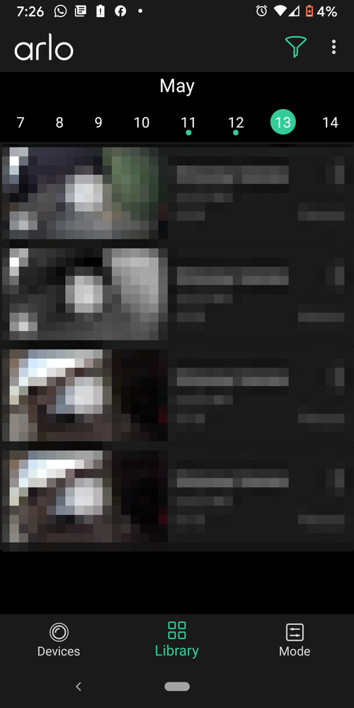

I have purchased an Arlo Set which comes with VMB4540 base station. I have on-going subscription on entryway camera and hoping to do without subscription on 2 others. So I have connected a USB disk, formatted, and things are getting recorded. But I cannot see them in the Library like I am supposed to? https://kb.arlo.com/000062337/What-is-Direct-Storage-Access-and-how-do-I-use-it!
In terms of instructions, I can't follow from step 3 as I don't see a cloud in the app?

Relevant screenshots attached.

Based on the screenshot, it looks like either direct access to storage isn't enabled, or that you are confused about what base you have. You might want to check that you received a VMB4540 and not a VMB4500. The VMB4500 looks very similar, but isn't a smarthub and doesn't support the feature.
Assuming you have a VMB4540, You can go browse to my.arlo.com, and look at the settings there. Select the base, and then "local storage". You should see this:
If you do see that, then click on the "Ready" next to "USB device". That should show you the total storage for your USB drive, and give you controls to format it or eject it.

PFA screenshots and pictures.
Could you please suggest what next?

If I'm understanding your posts correctly, direct access has never worked on the phone - correct?
One screen shot you didn't show was the one where direct access to local storage is enabled. I suspect that is set too, but just in case, you should probably double-check it.
Also you might want to make sure the app has the permission needed to use wifi data on the phone, and then test with mobile data disabled in order to ensure that the only data connection available is using your local wifi.
Deleting/reinstalling the app might be worth a try I guess (easy to do, though unlikely to solve it).
If you still aren't seeing it, then support is probably the only option left.
If you see the very first screenshot on the first post, it shows Direct Storage Access enabled. And I use Wifi all the time and am connected whilst I am doing this. Already tried uninstalling/installing the app. In fact do not see these locally recorded videos on my wife's device too which is an iPhone.
